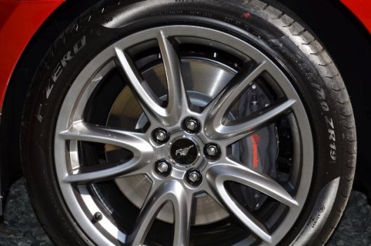

These wheels by chance?
I used 1/4” spacers on mine but 1/8” would have done what I needed, the biggest issue that necessitated them is the wheel weights would hit the spindle in front without them at all. If you use stick on weights on the inside when you get new tires you might not need spacers at all.
Offset is just that; the relationship from where the hub mounting surface is relative to the direct center of the wheel. 2011-2014 mustang wheels are +42, adding a spacer effectively shortens that offset by adding a to the hub mounting surface, so of using a .25” spacer you’re effectively subtracting roughly 6mm offset from the wheel, making the wheel+spacer combination a +36mm offset

The ideal offset is dependent on the car, and in our case the factory offset on the original 15-16” wheels is +39mm. It’s not hard and fast that you adhere to that but just as you saw going to extremes like the amount of space added with bolt circle adapters can be an inch or more and can put stress on the hub bearings. Personally I think the absolute minimum offset is use is +24 as that’s the typical SN95 9” wheel Mustang offset and our hub designs are for all intents and purposes the same (literally the same with the hub swap). Max is +40ish since you’ll run into inboard clearance issues at that point. Remember this; high numerical positive offset will tuck the wheels in, low numerical positive offset they’ll stick out of the fender, which is what you’re seeing on yours with adapters. Spacers and adapters effectively lower offset.
1/8” spacers are very safe to use, 1/4” ones you’re still good in terms of stud length however the hub bore will no longer engage the wheel making the lugnuts being the sole means of centering the wheel on the hub - which is fine for those wheels and normal tapered lugnuts but not ideal.
Wheel weights is not something you have to personally worry about, they are supplied and installed by the tire shop during the balancing process. There’s two types, conventional clamp on and stick on, from Ford those wheels will actually have both since there is no outer lip for clamp ons while there is an inner lip for the clamp on style. When you go to get new tires just simply specify you want stick on wheel weights only.
The factory tire size for those actually is the size you’re moving to; 255/40/19, those were what were on mine and those were low mile factory installed pirelli P zeros. Size wise at 27” they’re perfect for the Thunderbird. 255/45/19 is very tall at 28” I’m surprised it has them, in front without spacers they’d be likely to rub the upper ball joint, so going down to the 40 as you plan not only is a good idea but essential. The 45s work fine in the back though.

Yes they would, the other nickname for these wheels were Brembo wheels as the track pack came with the 14” brembos
Biggest con with these wheels is they were very heavy
