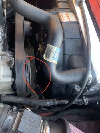

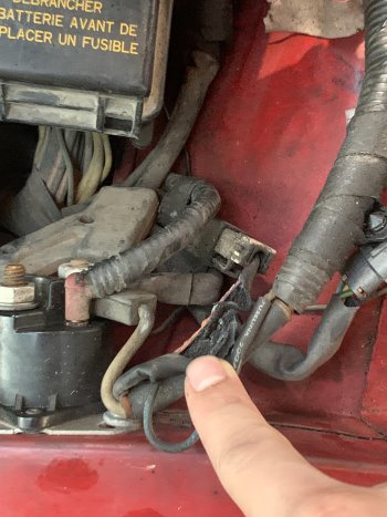

Hello everyone, recently picked up a 93 tbird sc. After finishing an oil change and coolant change, a wire near the battery started to heat up and smoke. I unplugged it to see if it was related to starting the car but the cars starts and runs idles fine. Can someone tell me the wire is and what could the cause be of the overheating. I'm thinking a ground issue but honestly, I don't know what the wire is for. Maybe the starter? I have posted on the SCCoA and got an answer but I want to get multiple opinions before tearing up the wiring system. Can someone guide me down the path to repair. Thank you!

View attachment 1810View attachment 1809

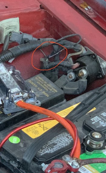

From what I know the previous owner was unable to remove the old cooling fan sensor so they cut the wire and spliced it together. I’m not sure the reasoning behind it. When we removed the fan to install my new radiator, we disconnected the wires. After installation my mechanic homie and I taped all the wires together in electrical tape in a bundle. Which may be the problem. I intend to undothe bundle and tape them individually. From what I read so far, the wire that heating up and smoking (see original picture) Per SC-Al at SCCoA, "I'm thinking the fuselink to connector C100. That would Go to the CCRM, (Relay Module), that powers the cooling fan.

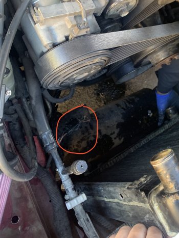

Edit: I just took a photo of the aftermath of the radiator install. It was originally spliced and held with the red piece. Post radiator install, we used electrical tape to bundle it which I suspect may have something to do it the fuse link overheating.

That may very well be your problem. Your splice probably has very high impedance. I would recommend crimp butt connectors at the very least, or solder and marine heat shrink if you have the means. They sell butt connectors that have solder in them, all you have to do is heat it to melt the solder. Looks like the pigtail is pretty short. You might want to go to a junkyard and grab one with more length to work with.
Edit: Your top radiator hose looks like it's almost kinked. You could cut some length off where it connects to the radiator to solve that.

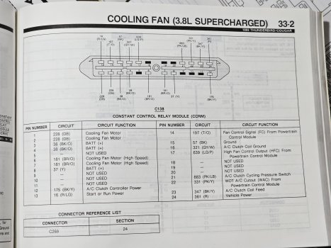

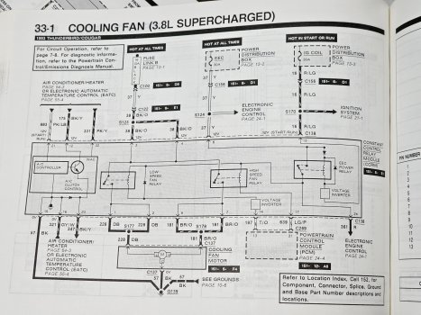

Here's the wiring for the cooling fan on your car. That fuse link is top-left.

Yeah, something in the fan wiring repair is shorting out.
Yeah, that's a bit high current for that. And normal .250 quick disconnects won't last either. I use a western union type splice, covered with heatshrink, after I solder it together. There are quick disconnects rated for 30A, I bought some off a buddy. If the end is melted, that pigtail is available. A large crimp will work there too, just cover it in heatshrink. Black tape melts under the hood, hst just gets tighter.

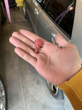

That wire nut isn't doing anyone any good.
