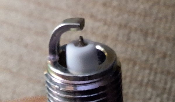

I dug out the plugs I had on-hand. The are NGK G-power TR55GP. When I bought them I believed them to be double platinum. I have never really inquired about what double platinum actually means. These particular plugs have what I believe is referred to as the "skinny" platinum electrode pictured below. Is it really worth getting a set with "thick" electrodes considering that I bought these plugs well over 5 years ago and I suspect they have at least doubled in price...

I've had bad luck with those; the little platinum "puck" melts off. That's why I get the double platinum with the larger center electrodes. Those worked great when Champion started making them in the 70's for my 2-stroke. Our ignitions have a lot more energy.
Well, I put them in yesterday while the intake was off for resealing. The ones I removed were the original Autolite. The only reason I say that is it's a low mileage car (93K maybe...the odometer gear is broken) and every electrical connector that I'm removing, the locking tab is intact. There are also other things that lead me to believe that I'm the second owner and that the first owner did NO maintenance whatsoever!
How? I run the fine electrode plugs in my blown 4V with no issues. A-Train even did a write up recommending them for high cylinder pressure situations.
Lazarus eats them like candy; several brands, so it's not the brand. the larger ones do fine. I've checked the mix, it's not lean. Even the failed plugs were tan.
