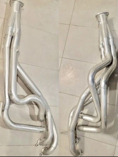

I saw there SHM headers today and I don't think I've seen a design with no primary engine flange AND slip fit collector before. The primaries look like 1 5/8". The length does look nice. What do you guys think?
First look, I think the primaries on the driver's side may be too far out after the bend towards the back of the car. Think you'll have frame rail interference. Passenger side, I think the third primary may be too far forward and hit the K member. (Unless you went AJE)
